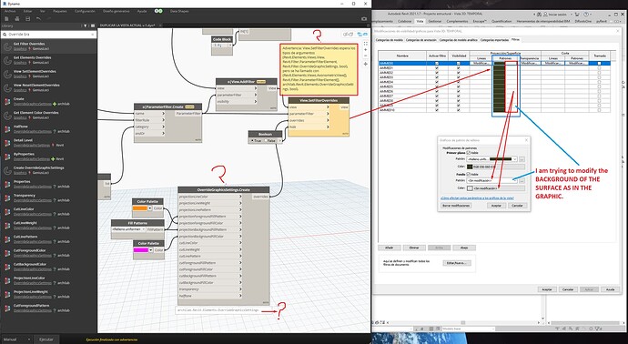

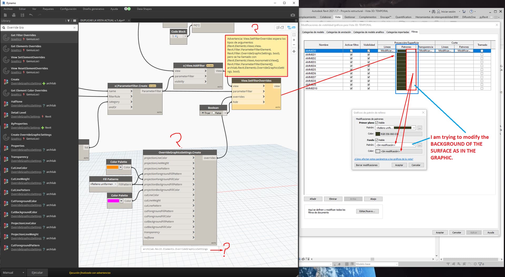

I am trying to modify the background of my pattern surface and I don’t know with which node I can perform this action.
I would really appreciate if you could share me a node of some package or some PYTHON SCRIPT thanks…

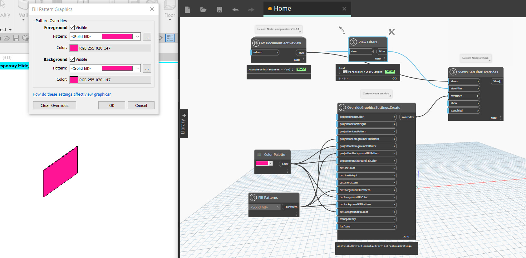

Hi @AM3D.BIM.STUDIO Your ootb setfilteroverride node only accept setgraphic override from ootb, as you use archilab then it will fail… try archilabs set filter override node instead…
Thank you very much it helped me a lot.
