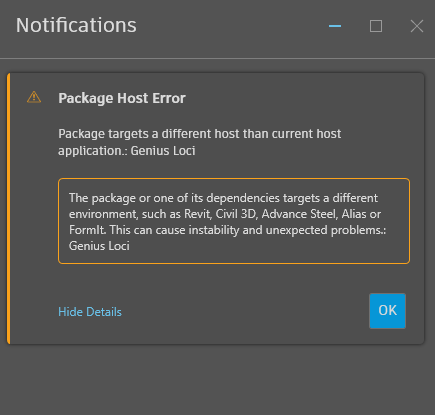

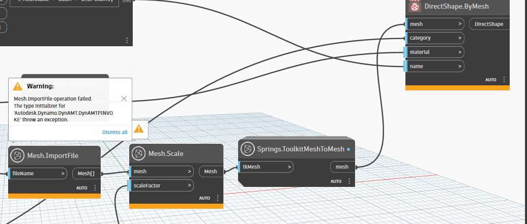

Working through upgrading my scripts to work on a variety of Revit versions. Regarding updating my script for mesh imports, it returned the following in Revit 2024.
For versions 22 and 23 no issue…any ideas?
The same issue in the initial post exists within Revit 2025 and therefore no mesh is imported.
Any thoughts on how to resolve this issue, much appreciated. I have attempted to find the stated issue, with no luck currently.
Assuming that is a mesh node from Mesh ToolKit, have you installed the right version for your Dynamo build? Check the description carefully.
