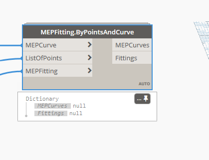

i’m trying to use this node to add duct damper on the duct but it did not split the duct and add the damper

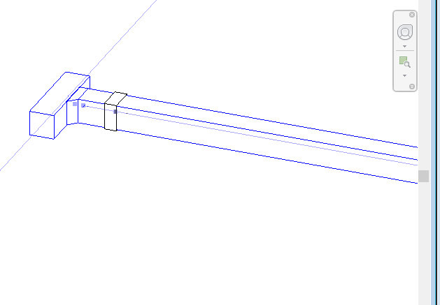

it just put the damper without connecting it

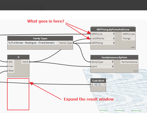

Could you show the output of the nodes that go into the MEPFitting. ByPointsAndCurve node?

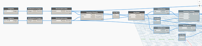

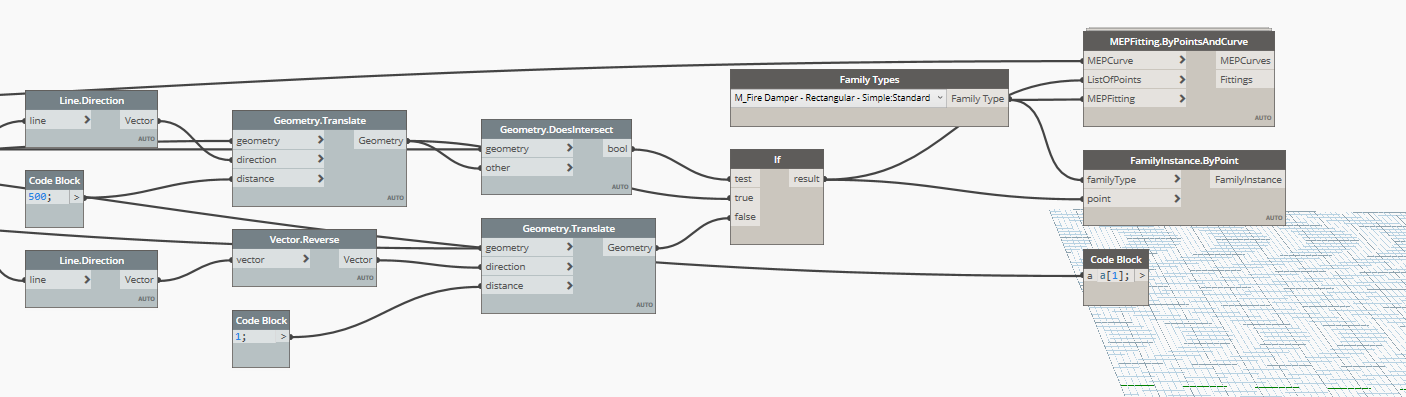

this is the out put
4
I actually meant the results of the nodes that go into the MEPFitting node, so the inputs for the ListOfPoints and the MEPCurve
