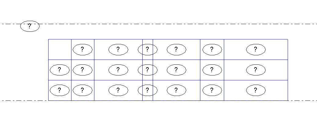

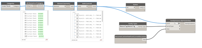

Hi Forum,
I have managed to get a simple script going to automate material tags on curtain panels. However the issue I am facing at the moment is that, the tag is simply using the point location from center of the panels without actually hosting to them, hence the null value.
Is there anyway to make tthis work?
Thanks in advance
Kevin

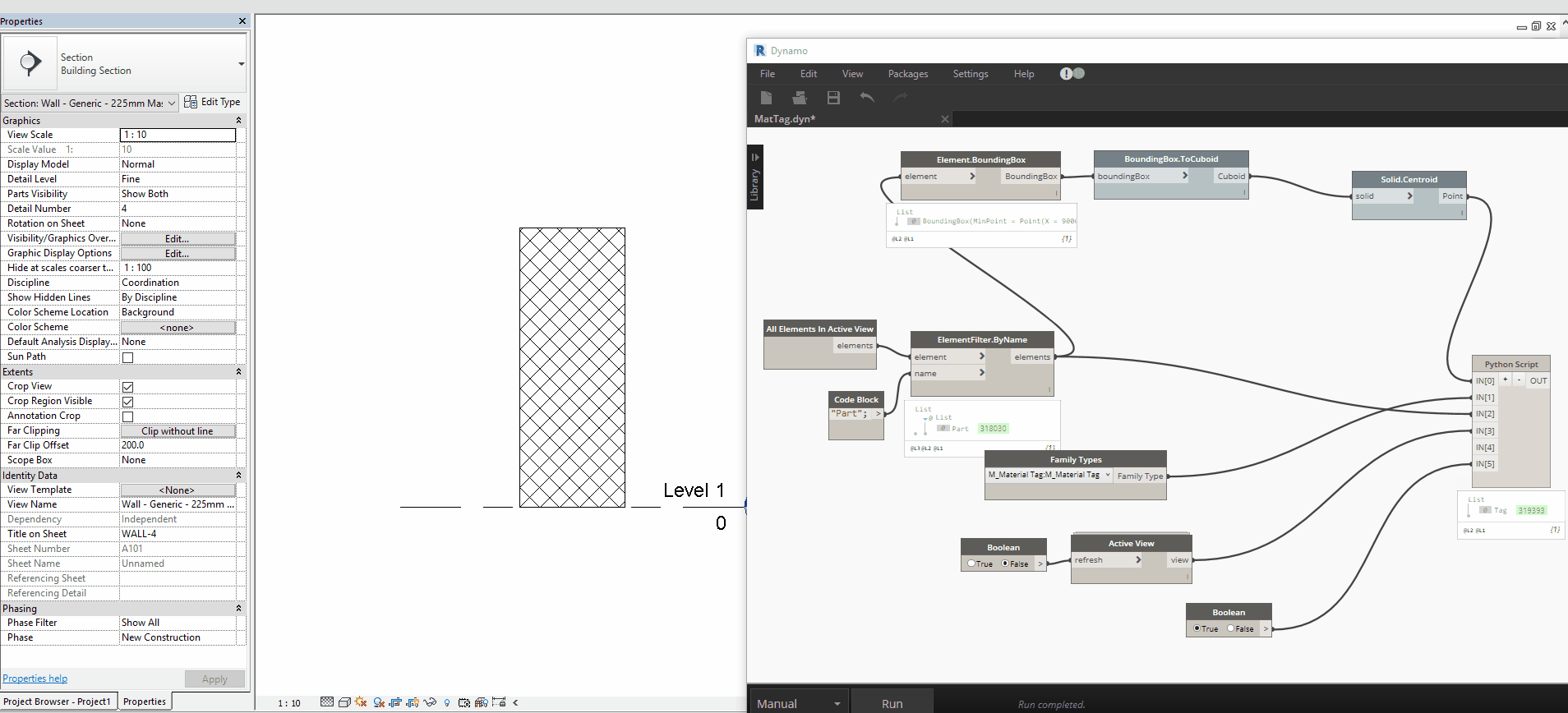

Hi @JacobSmall
Sorry I was away for a few weeks and didn’t get a chance to post the files prior to my leave. I believe using a surface pattern would be a good alternative to convey the data content, however I am currently quite restricted by the company’s standards. But I will bring it up in the next BIM meeting and hopefully have it resolved.
Meanwhile on this topic, and also for my own learning curve, I would still love to understand the logic behind how to execute this python bit. Please find the test dyn & rvt files attached.
Thanks in advance,
Kevin
MatTag.dyn (15.8 KB)
Test File.rvt (392 KB)
