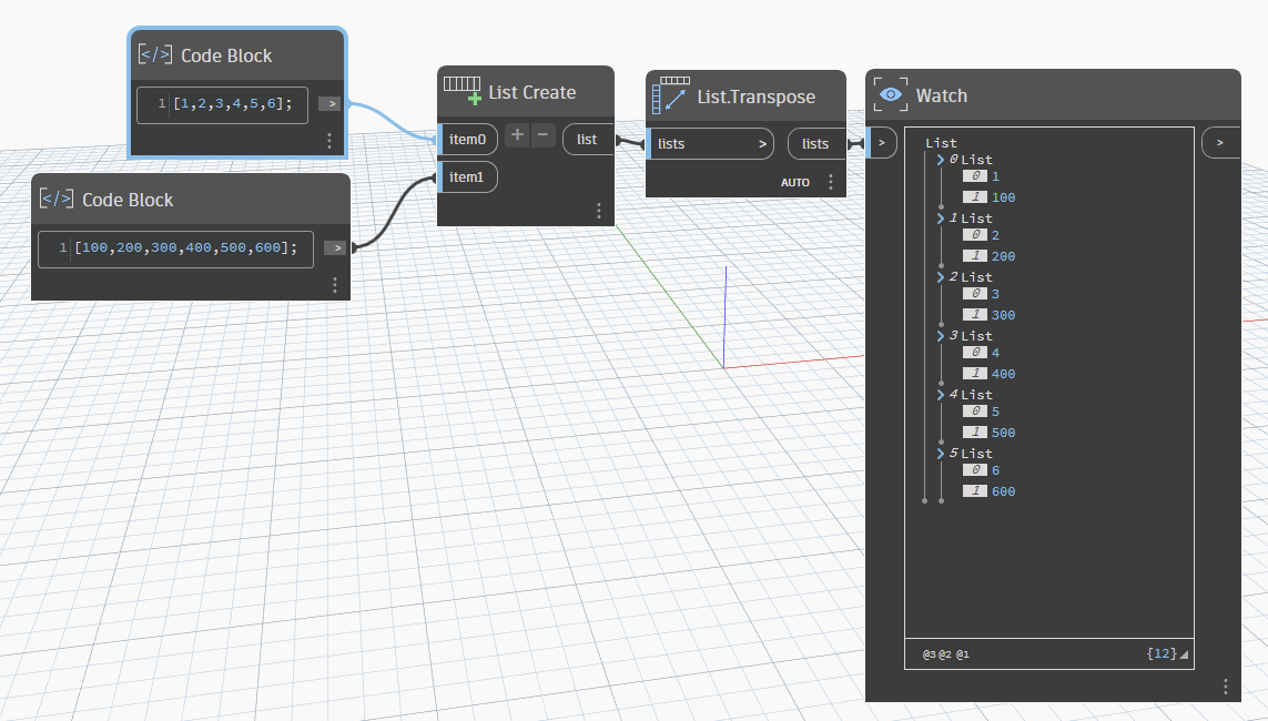

It might just be something like this?

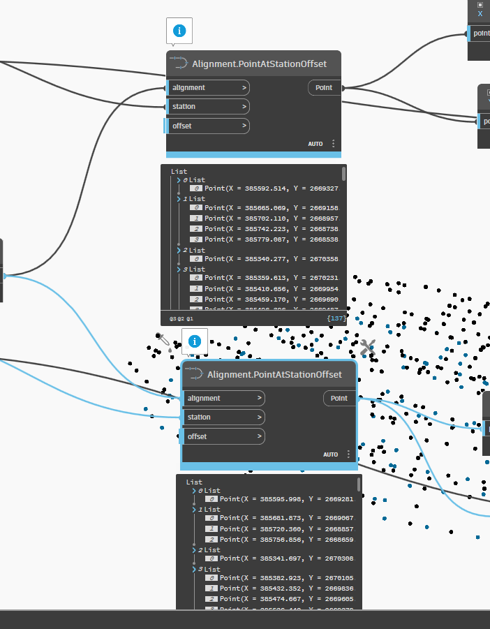

like in this picture , there are lists of points from the highpoints node and from the lowpoints node , i want to combine each list with the corresponding one.
The example @pumpaij shared should help explain the concept of what you’re after. Your list levels will require an additional transpose to groups the subgroups.
Thank you , it really helped i appreciate it.

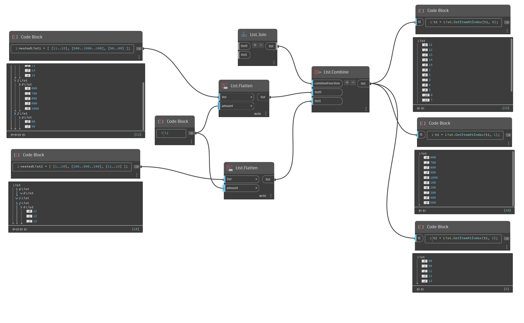

And thank you @Nick_Boyts for pointing it out , i also wanted to know after combining the two lists how can i extract each list separately?
Thanks in advance
you want to combine the lists, then split them again ?

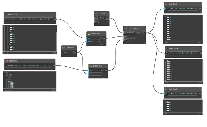

No, i want to combine the sub lists from two different lists and them extract each new list , for example in the following picture , new list 0 will include 2 points and list 1 will have 7 points etc , i want to extract these new lists separately
possibly simpler methods, but this is one way to understand it
Thank you so much
