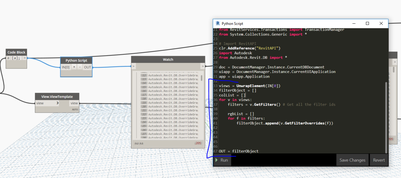

So after more playing around, I found out that you can edit the original filters, the below is changing the filter colour.
The problem I am having at the moment is there is no unique way of identifying the filters. I need to extract the name so I can know what the value needs to be set at.
Final Edit for those who may need it in future:
If you want to get colours out: you need to extract the OverrideGraphics, I did this by editing a bit of code found elsewhere on the forum. Input in the view.
Then extracted the colours like this
To change the part you want to extract, change SurfaceForeGroundPatternColor to what you need (See https://www.revitapidocs.com/2020/9540ce59-84a6-a9db-7a5f-6e3e616450bc.htm for list)
You simply need to get the element name like this
