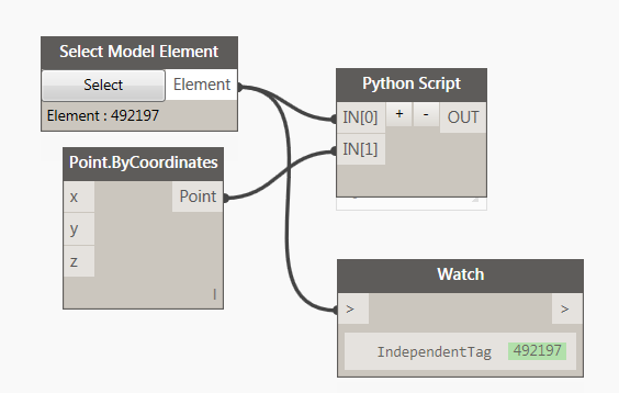

Hello mr. Kahre:
Here’s how to move a tag to a new location:
(Tags doesn’t have a location point, use tag.TagHeadPosition instead)
clr.AddReference('RevitAPI')
from Autodesk.Revit.DB.Structure import *
clr.AddReference("System")
import Revit
import RevitServices
tag = UnwrapElement(IN[0])
newPoint = IN[1].ToXyz()
tag.Location.Move(newPoint - tag.TagHeadPosition)
OUT = IN[0]

Hi @Jan_Christoph_Kahre
from Autodesk.Revit.DB import*
import Revit
xyz = tag.TagHeadPosition.ToPoint()
OUT = xyz
