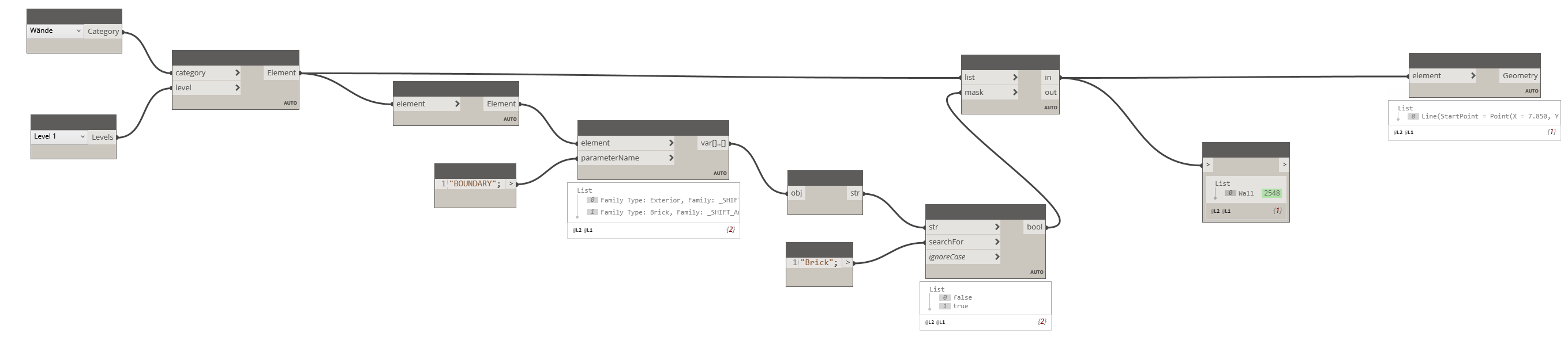

I wanted to explore your suggestion as it sounds like to might process faster. I’ve gathered up the wall types but run into trouble further filtering the WallTypes based on type parameter. Walls w-Type Parameter getting WallTypes first.dyn (19.6 KB)
It looks like you’re searching the type name for the parameter name which obviously isn’t going to work. Either way, I was suggesting you start with the types instead of the instances so that you don’t have to deal with every wall instance in your project at the beginning. Something like this should work. Python is probably the best way to go about getting the wall instances from the filtered types, but you can also use this Springs node.
