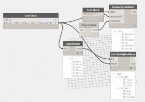

You could use ReplaceByCondition node to replace null values.
Put the Object.IsNull on condition input and replace null with your want.
Or use List.FilterByBoolMask node to Remove null values.
like the image blow

Thanks Wy, Exactly what i needed.

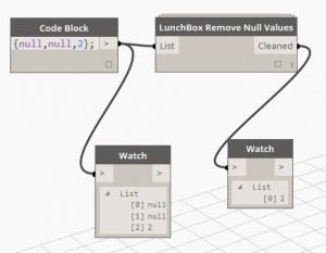

Nathan Miller’s LunchBox also has a node for that.
remove Null
