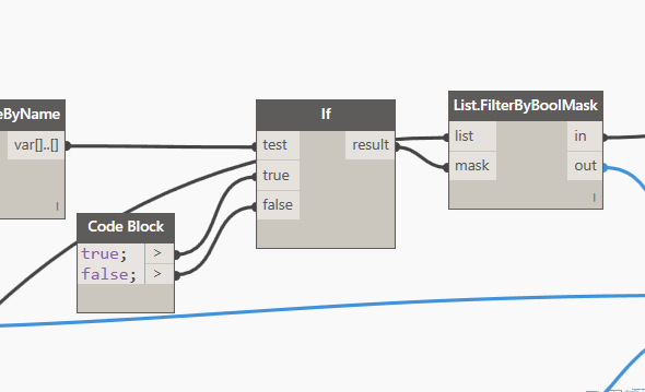

How to filter empty value in a list?
See my atempt in the pic.
Filter empty list
I’m not super up with the play, but try “” next to each other. At this point your filtering by a ‘space’. Worth a shot :smiley:
Filter empty list solved
:slight_smile:
Check it out:
The If node, with a true/false, seems to resolve this, esp. for using with the filter by bool mask.
You can use a simple line in Python, to filter null values:
OUT = filter(None, IN[0])
all the null values will be removed from your IN[0] list.
