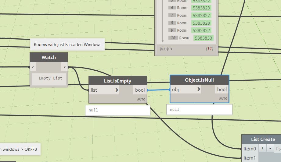

Hi All,
List.creat node return NULL . Any idea ?
Looks like you need to close and rerun your graph.
i did that too many times
i will try to reinstall Dynamo
Which Revit Version you’re using? Make sure you have the latest Revit build version.
2021.1
list.creat somtimes read the data and sometimes not
21.1.0.108
20200708_1515(x64)
2021.1
i think the problem came from Revit becuse i tried it with different data it works but when i came back to the same data it wont

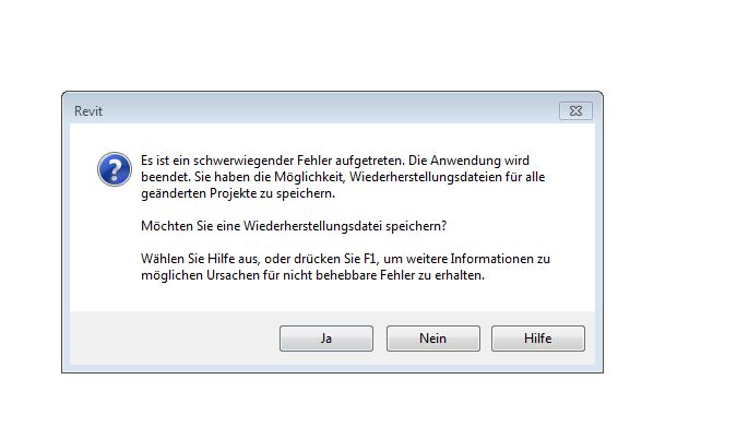

Revit bug, i tried to duplicate the floor plan and he gave me error .
thank you every body for help, we will always learning
Use 2021.1 2 2021.1.2 Hotfix
