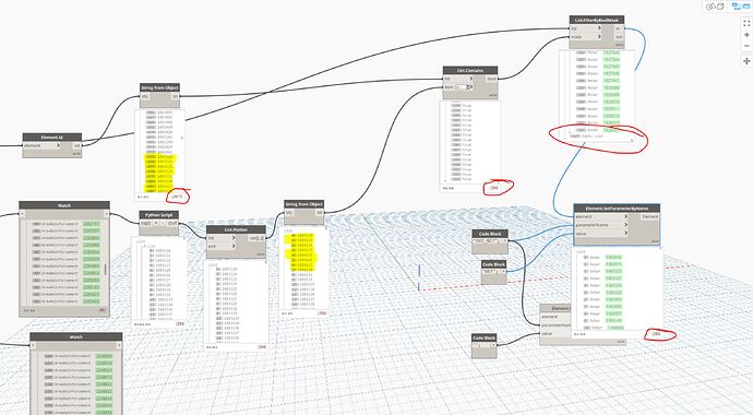

I want to filter out all the rebars that are associated with a Structural Area reinforcement.
With a Python script i got the GetRebarInSystemIds() . Then set a parameter with a specific text.

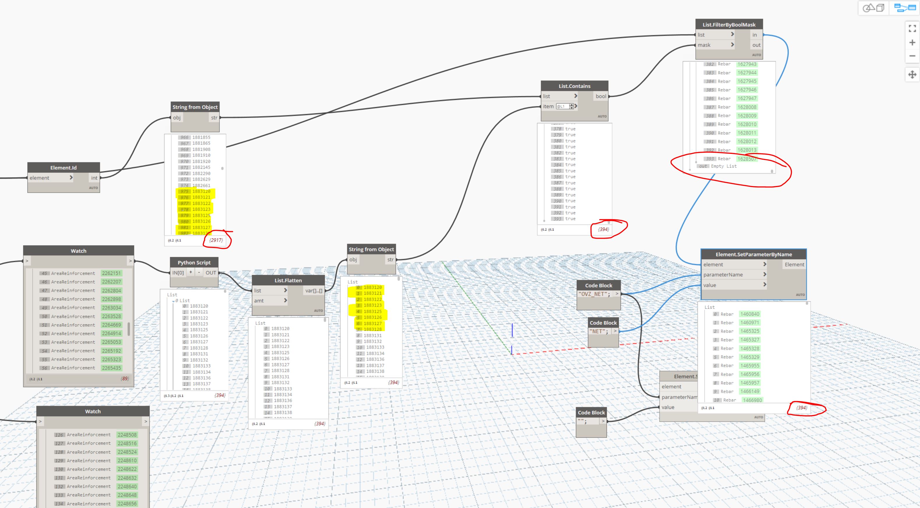

My list should contain 394 items containing the first list. When i manually check the lists i see the lists are correct, but the output at the List.Contains node is not correct.
Any insights would be nice.
@gerbenKAG9F You can either swap the inputs of List.Contains node or use the List.IndexOf node as shown below to get the desired result.
Option1 worked.
I was sure I tried that…
