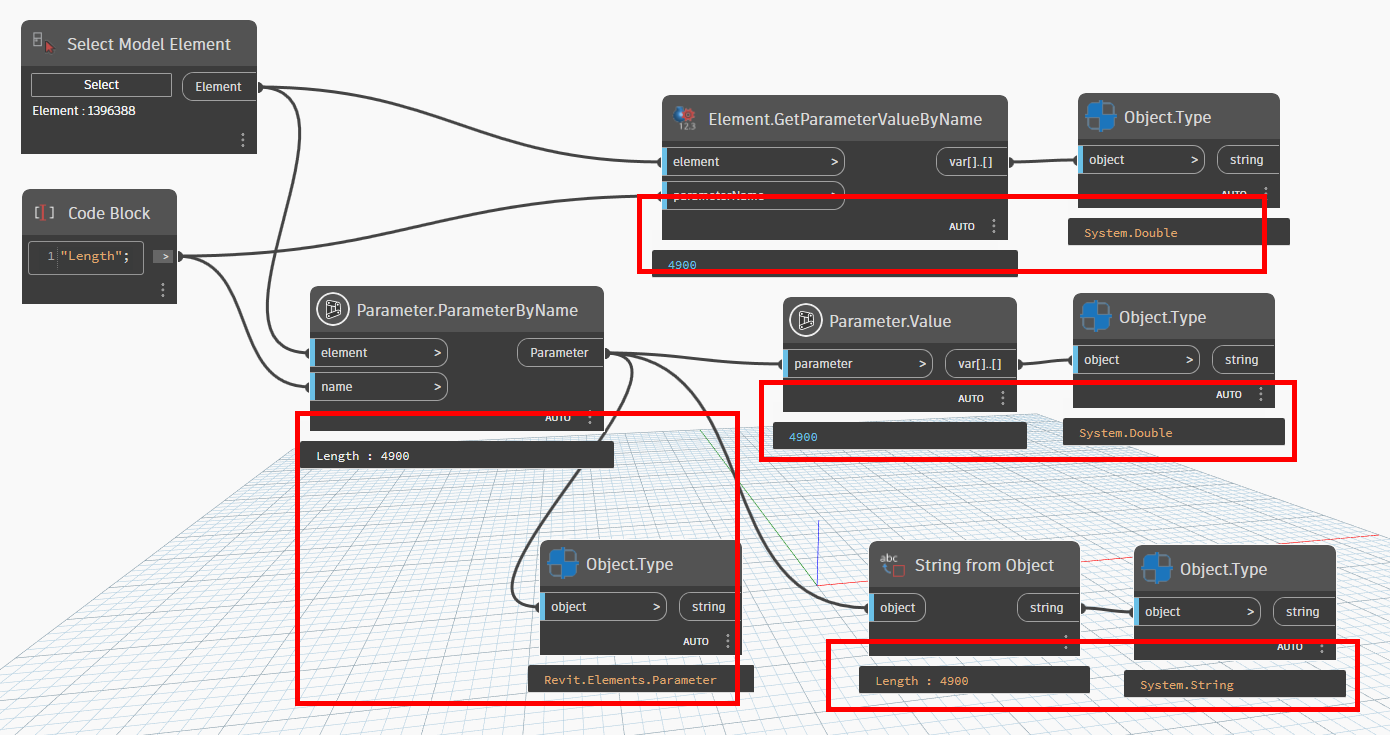

I am trying to filter a list of shared parameter that contain or equal to Length but its it is showing as false?
I guess you are having a Level issues and feeding the wrong (type of) values.
try to change the lacing and set to longest, or play with it if you can get your desired result
Hi @victorJohn.gregory maybe something here you are after
Thank you Sovitek this work!
To further clarify.
You can tell by the color (white, blue, brown) what the Object.Type
is.
