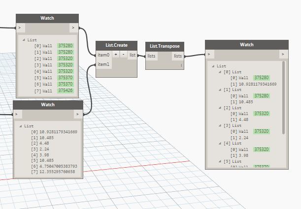

So, I have a List A with Wall-IDs. The Walls are divided in multiple parts, so the same ID appears there multiple times. Then I have List B with represents the length of each part of the Walls.
The Goal is, to make a List with the Wall-IDs and assign the correct length as a sublist to each Wall.
Wall 1 (part 1)
Length 1
Wall 1 (part 2)
Length 2
Wall 1 (part 3)
Length 3
Wall 2 (part 1)
Length 4
Wall 3 (part 1)
Length 5
Wall 4 (part 1)
Length 6
Wall 4 (Part 2)
Length 7
Then I want to sort all Wall-IDs and have all length of the same wall under each other.
