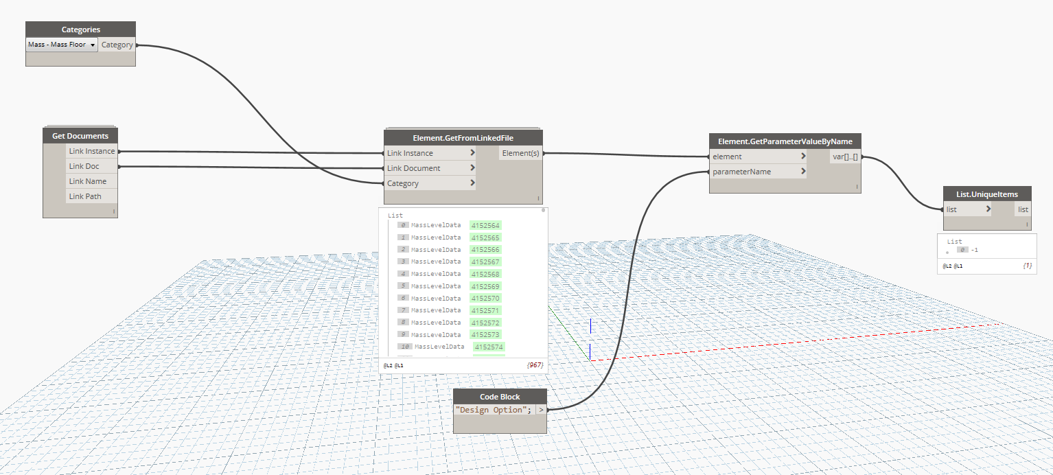

When working with linked files it would be great to be able to get access to the Design Option data within linked elements so that data can be filtered per design option. This doesn’t appear to be the directly accessible through “Element.GetParamaterValue.ByName”. Instead all I seem to see is “-1”. Any ideas on how to get hold of this information?
I believe -1 is usually the “default” value or Main Model in this case.
Thanks - that clears up the -1 matter. Wasn’t sure if the database could see the design option data within the linked model but have done a quick test and looks like it does.
