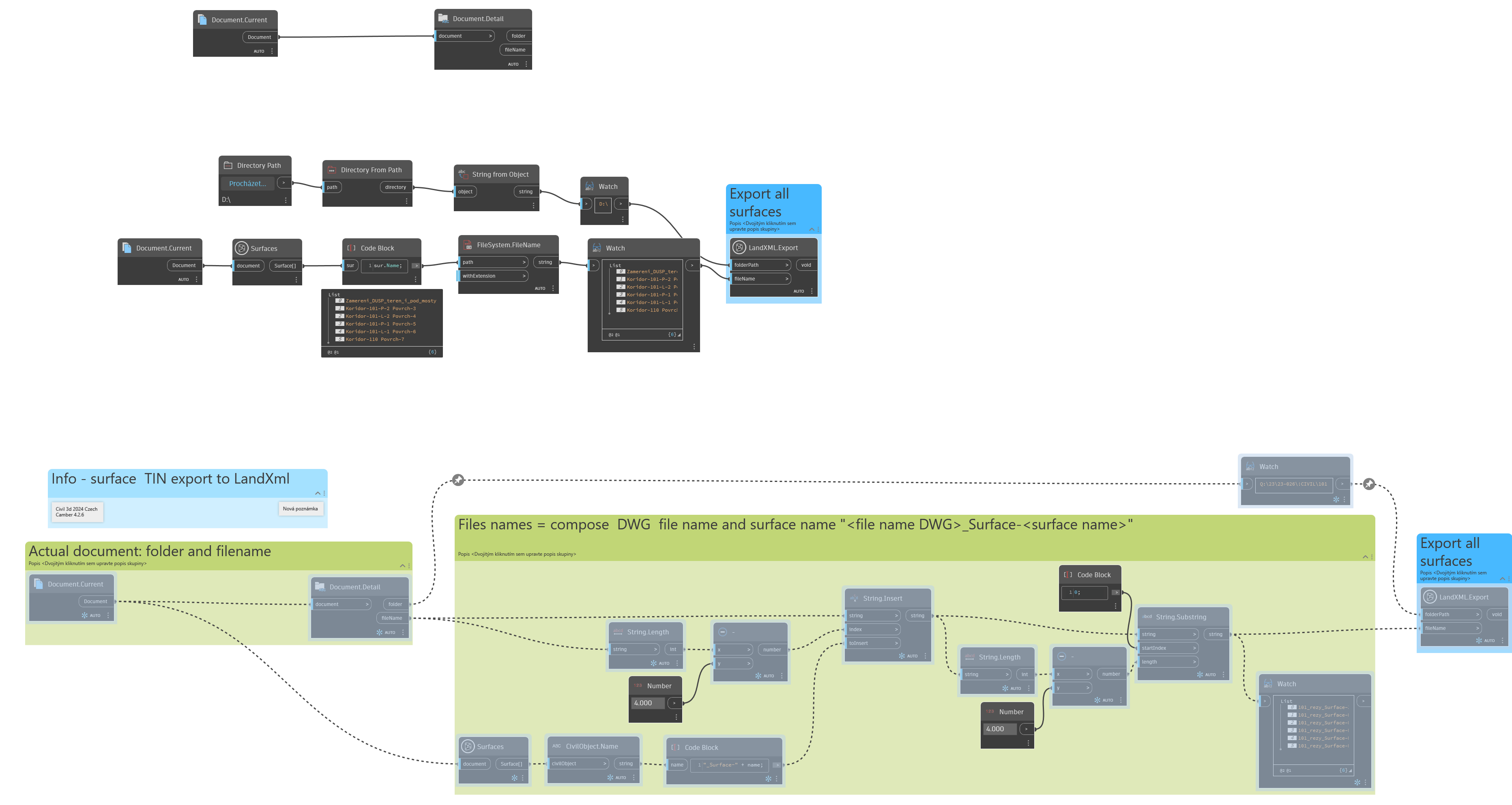

Yes! I want to export all surfaces in a drawing to specific LandXML files one by one.
It is possible now :+1:
See in my webinar in time from 27th minute https://attendee.gotowebinar.com/register/5899756622071748438
Will the webinar be in english? Do you have a better screenshot, can’t see the name of the nodes.
The webinar is already recorded and available for everyone here. There is nothing complicated. You need only few minutes of your time to see how it is done in video from 27th minute.

Camber LandXML export problem
Hello, I tried Drbohlav scripts (import/export LandXML), btw thanks for sharing.
Export Multiple LandXML Files_0.0.1.dyn (51.9 KB)
The import works nicely, but the export is giving me an error. On the command line, it wants to enter the version of LandXML, so it breaks the script flow.
I tried it on, with the same result:
  • Civil 3D 2024 Czech, Camber 4.2.6
  • Civil 3D 2024 English, Camber 4.2.6
  • Civil 3D 2025 English, Camber 5.0.0
Can you advise me where is the problem?
