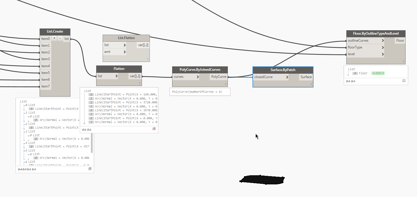

i did the flow you have sent me for one level and it succeed,
but when i run it with all levels, it was failed, I believe there is a need to isolate one level list at a time… how do i do this?
this is the printscreen of the multiple levels result
I succeed running the operation with all levels with isolating one level by “list.getitemAtIndex” and “List.Map” while putting specific number for index…
i tried to put for index the full list of sequence (all levels) and it does not work…
In this node “Polycurve.ByJoinedCurves”, click on the arrow > and set it to use levels (2). I did not tried it here but I guess it might work. Do it on that example you sent that is without the part with the “GetItemAtIndex” node

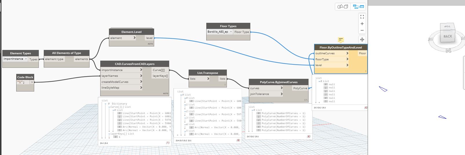

Hello!
I am trying to apply the same development by extracting the autocad lines but I have no result
I am attentive to the help, thanks!!
