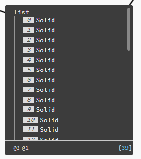

I have a list of solids that I’ve created and now want to check to see if they intersect with each other. Need some pointers on how to iterate this list so that the 1st solid checks for intersection against the rest, the 2nd against the 3rd through the remainder, 4th against 5th through remainder, etc.
