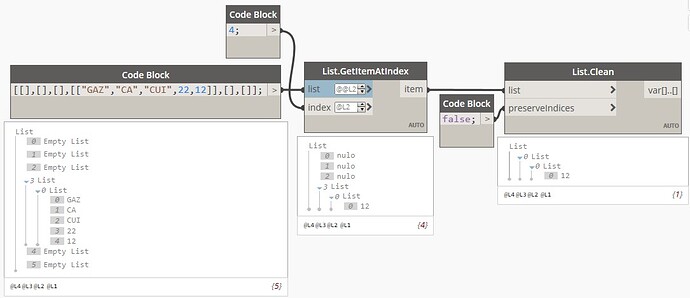

Hello everybody !
I’m trying to get the item at index from alist but without altering the list structure
I’ve tried different lacings but it dosen’t work ! Thanks for helping !
Hi @deejaypein ,
Like this?

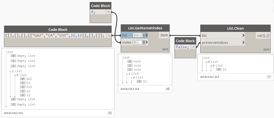

Hello @EdsonMatt ,
Which Dynamo version are you using ?
because in 2.0.3 i am not able to get double @ ( like in list “@@2”)
@EdsonMatt
Thank you good sir ! the result wanted is the outpout of the getitematindex just before the list clean . ithink i had to assign the level 2 on both list and indext ! thanks a lot !
I’m using the 2.3.0.5885
