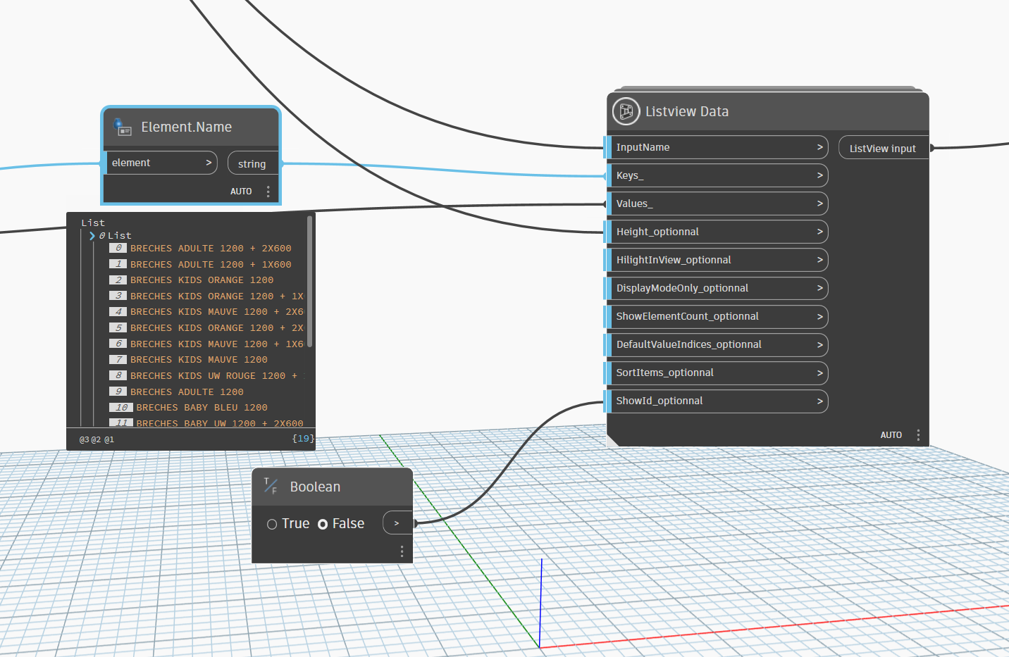

Please run you graph in Dynamo and provide an image of your graph that shows the returns from the nodes that are supplying the list of elements being inputted into the Multi Input node. One of those nodes would be where the issue is coming from.
Here’s a snapshot of input.
The 19 items are clearly visible.
Looks like you have too many levels in the list. I recall Datashapes needs no deeper than @L2 for this to work.
The strange thing is that on version 2021.2.6 with Revit 2023, I had the same level of list and it worked.
I’ve flattened my lists and it’s better. Now I just need to understand why the frames overlap.

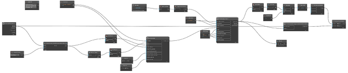

First guess is that there is a width input or two which are off, but you haven’t posted your canvas as an image so I can only guess.
Here is the canvas:
I believe the overlapping started with Revit 22 or 23. You will have to edit the code of the node to fix that. I am not sure if there is another way to fix that or not.
