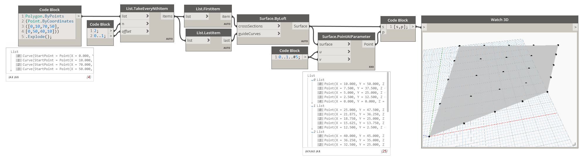

Is there a way to set the domain of uv surface?
It create points outside the surafce when I use Surface.PointAtParameter(Picture1). But what I really want is create point in side the surface. How can I make it?(Picture2)
Avoid creating surfaces by Patch, instead build using using cross sections and guide curves
pointAtParameterDomain.dyn (17.9 KB)
