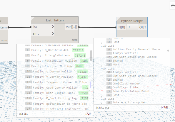

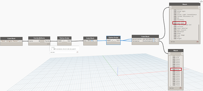

Here’s a graph and some test files I’ve been playing with, you can see that I am correctly returning the Type Parameter exists, but incorrectly returning that the Instance Parameter doesn’t exist.
In the same way that a family instance does not have access to type properties, a family type does not have access to instance properties. I think your only other option is to open the family document and check the parameter list there.
But it’s a niggle… Obviously we do see these in Revit… when I get in the office tomorrow I’ll have a play with Parameter Maps… it does seem to be operating in a Family class rather than a Type class… It says All Parameters…

import sys
# Import RevitAPI
clr.AddReference("RevitAPI")
import Autodesk
import System
den = UnwrapElement(IN[0])
dln = []
output = []
for d in den:
dln.append(d.GetOrderedParameters())
for dl in dln:
paramNames = []
for l in dl:
paramNames.append(l.Definition.Name)
output.append(paramNames)
OUT = output

But yes, I was hoping when the documentation said ‘all parameters’ it meant through the sub-classes, but it doesn’t… So I just get the parameters directly available to a family, e.g. Shared, Hosted (or I get the Type parameters if I run it on a Type).

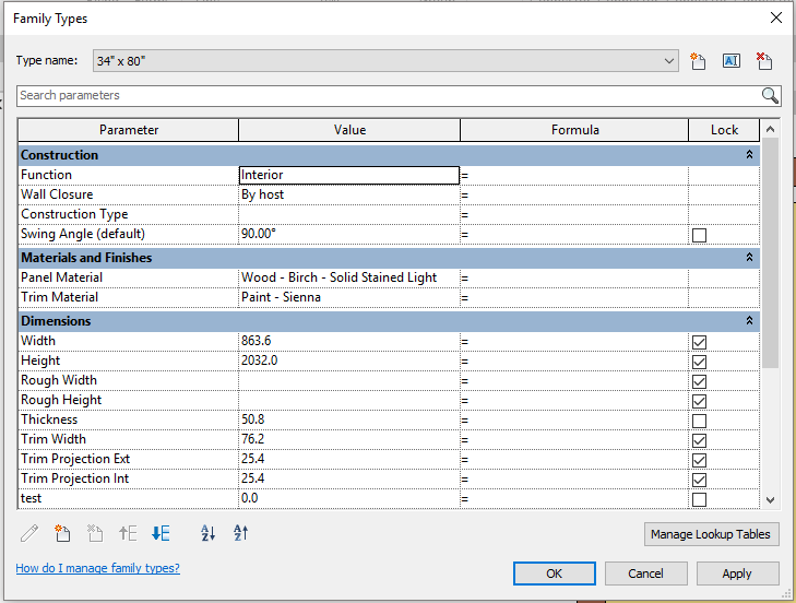

No… if you see my screen grab, ‘test’ is a Type and ‘test int’ is an Instance…
It is basically automatically opening the family from inside the project, reading the dialogue you get when you hit the blue squares, then closing the family again…
