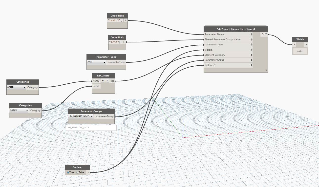

how its possible using API?
i cant find this option :
http://www.revitapidocs.com/2018.1/c3bed87a-956f-47c3-060c-0294c7ef43e7.htm

but i am looking for API method to set instance or type project parameter
My bad)

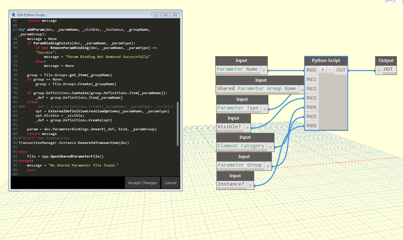

solution already exist of course
if _instance[k]:
		bind = app.Create.NewInstanceBinding(cats)
	else:
		bind = app.Create.NewTypeBinding(cats)
