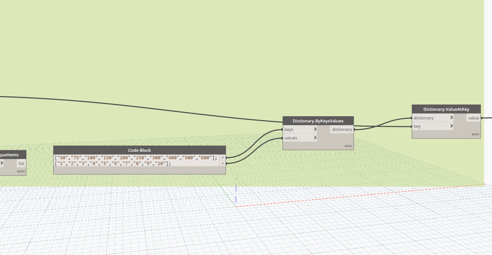

I made a graph to assign Keynotes to Cable trays & fittings.
It does contains some “little schedules”, e.g. for a Dictionary.
I am wondering where to manage these…Acces? A big Excel document, a dedicated application for databases, a loose collection of .csv files in some folder?
Somewhere Dynamo finds it, the application that makes the “Bauvorgaben”, and the EIR.

this is my testcase; a graph that applies Keynotes to Cable Trays & Cable fittings simultaneously.
I thought it was a good case, as there a many combinations, it applies to both system & loadable families.
The data goes through Dictionaries and Key schedules which I would like to store in central location.
Keynote samenstellen met dictionary 06.dyn (193.4 KB)
