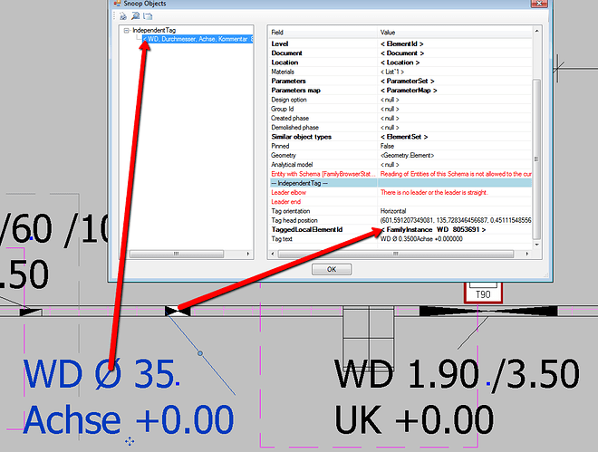

Hello Hello,
In Revit Lookup I can find the tagged object of an independant tag… see the picture
so… is it possible to get to that parameter in dynamo also???

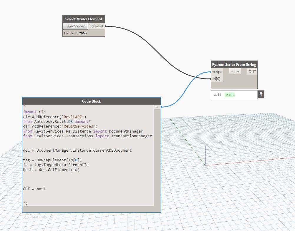

Hi @Jan_Christoph_Kahre ,
strangely enough there doesnt seem to already be a node for that… Anyway here’s how you can get it:
clr.AddReference('RevitAPI')
from Autodesk.Revit.DB import*
tag = UnwrapElement(IN[0])
id = tag.TaggedLocalElementId
host = doc.GetElement(id)
OUT = host

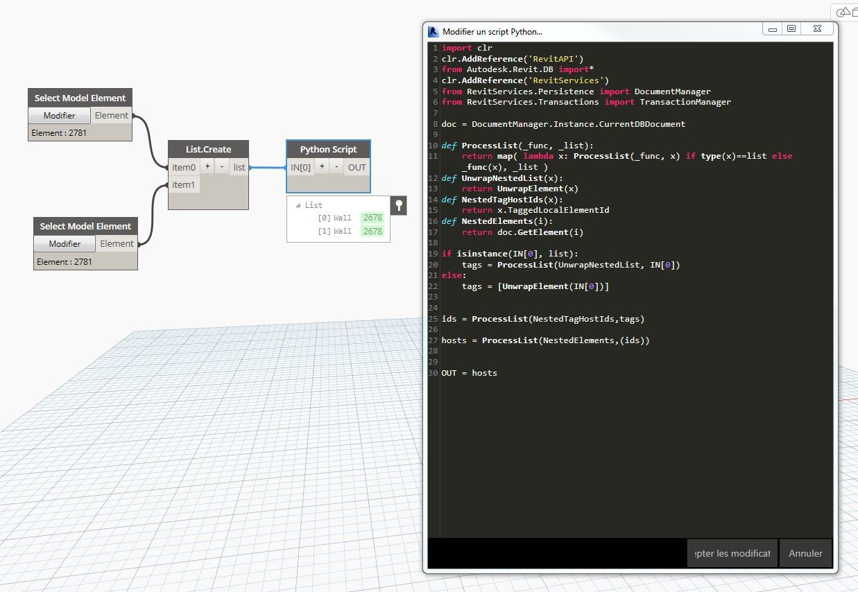

Here’s a better version that works with nested lists
def ProcessList(_func, _list):
return map( lambda x: ProcessList(_func, x) if type(x)==list else _func(x), _list )
def UnwrapNestedList(x):
return UnwrapElement(x)
def NestedTagHostIds(x):
return x.TaggedLocalElementId
def NestedElements(i):
return doc.GetElement(i)
if isinstance(IN[0], list):
tags = ProcessList(UnwrapNestedList, IN[0])
else:
tags = [UnwrapElement(IN[0])]
ids = ProcessList(NestedTagHostIds,tags)
hosts = ProcessList(NestedElements,(ids))
OUT = hosts
Mostafa_El_Ayoubi !!!
