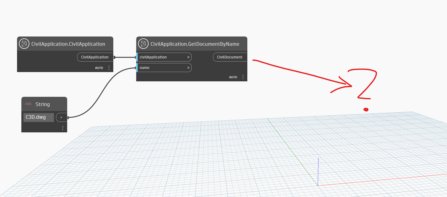

Import 3D volume from Civil3D to Revit with CivilConnection
How is it possible to import 3D volume (which is not a corridor) from Civil3D to Revit with CivilConnection?
