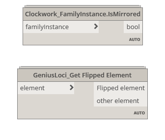

Hi @wwdreamb,
Use the FamilyInstance.IsMirrored node in Clockwork package.
For flipped elements, you can use the Get Flipped Element node in Genius Loci package.
