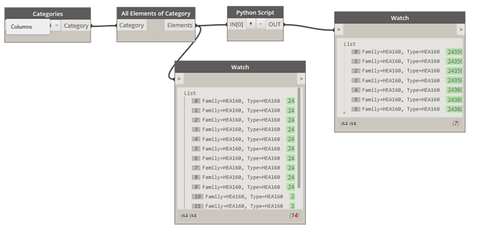

Hi @Draxl_Andreas,
# Import RevitAPI
clr.AddReference('RevitAPI')
import Autodesk
items=UnwrapElement(IN[0])
mirs = []
for i in items:
if i.Mirrored == True :
mirs.append(i)
#Assign your output to the OUT variable
OUT = mirs
https://apidocs.co/apps/revit/2019/20ab2f32-e3ca-8173-aac3-a03e998fd0ab.htm
P.S : The walls don’t have a Mirrored Property, it’s only for the familyinstances.
Ahh ok… when i mirror a wall with doors so just the doors get the “track” of beeing mirrored, ok i understand
