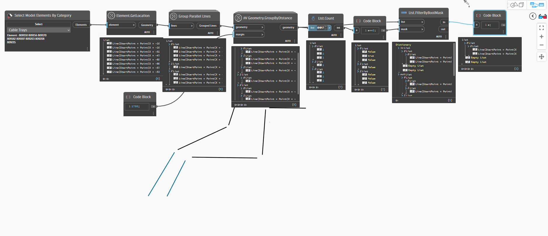

H @parikshit.thombare8X i can be done many ways, here is one

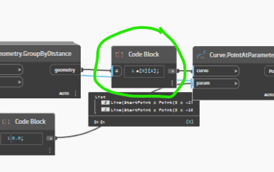

hello @sovitek can you please explain me what you did with code block here?
it was just a fast way to sort out in this example…you could do that this way here as well
great! thanks a lot. I shall try this.

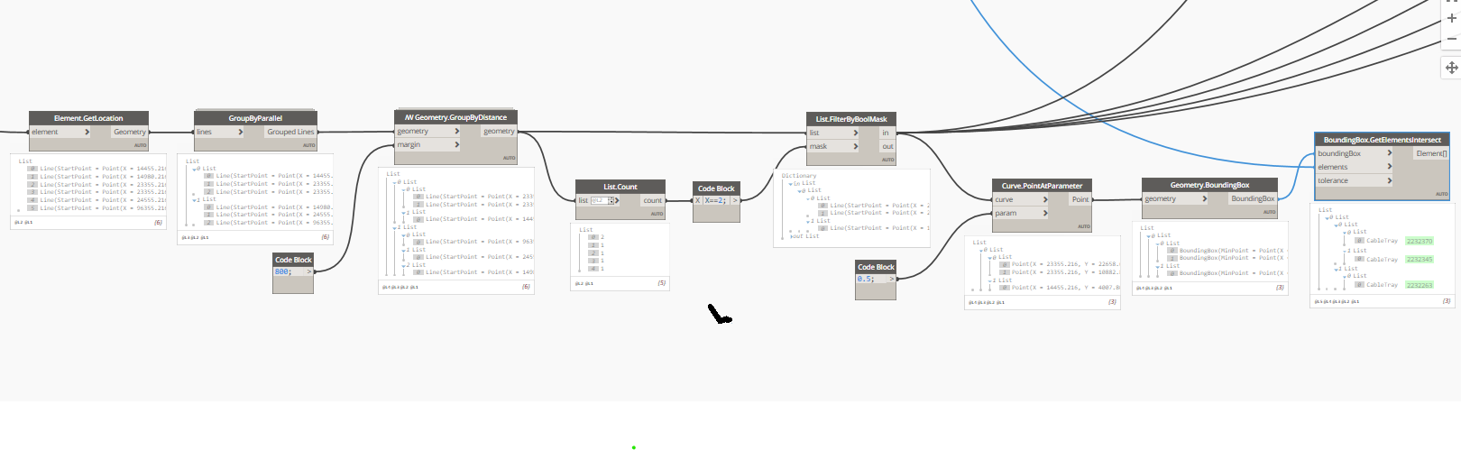

Hello @sovitek ,
I have tried it per your suggestion, but something is wrong with my script as it still select points on all cable trays. see snaps attached.

Hi @parikshit.thombare8X something here could actuelly work in that case
@sovitek as per my observation it seems that two inline cable trays are getting grouped together instead of parallel ones.
yes true
try parallel them first as showed in other post here, i just try on your sample…and if you try on a big complex system many things go wrong…play around with it
