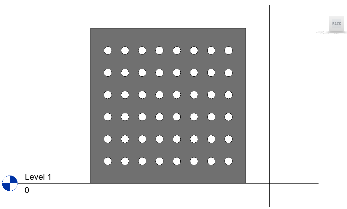

I want to create Wall with circular hole
As shown in the attached image, I want to create a wall with a circular hole that can be easily produced in Revit using Dynamo. I confirmed that the floor slab is possible, but I’m not sure how to approach the wall.

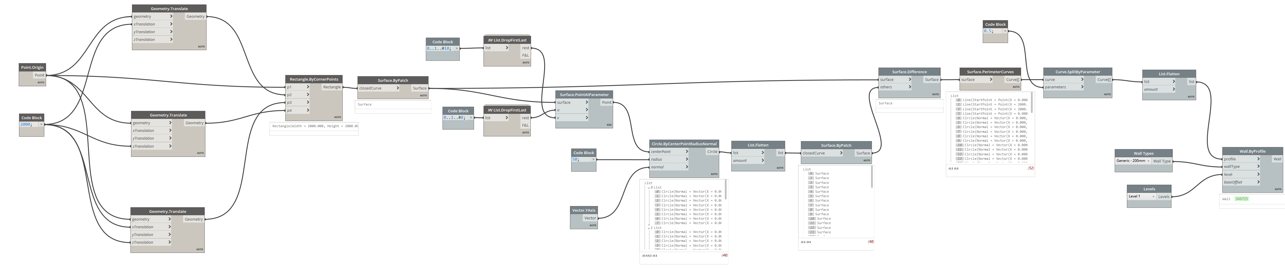

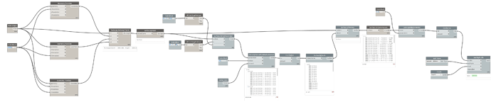

Hi @GGG
Try this:

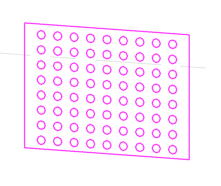

And here is the result in Revit:
