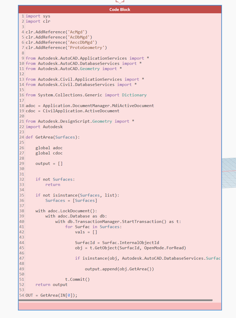

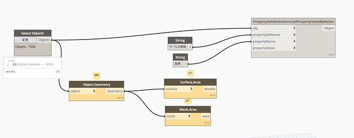

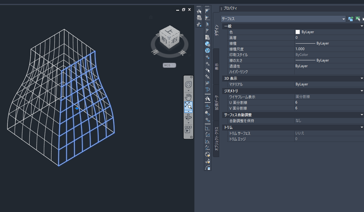

I want to calculate the area of a surface(Autocad surfaces, not TIN surfaces) in Civil3d
I would like to create a Dynamo that measures the area of a surface (Explode Solid), but I just can’t get it to load. Could you please advise?

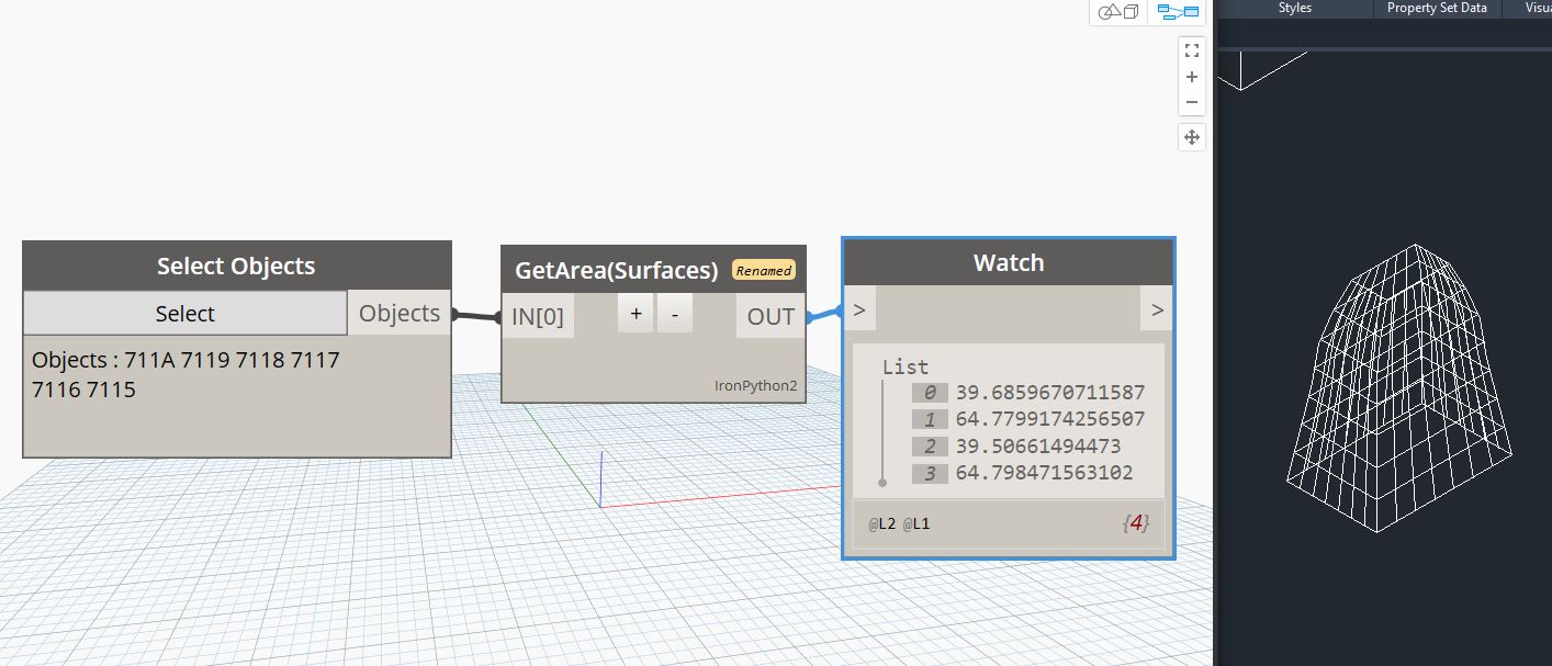

hi
try
import sys
clr.AddReference('AcMgd')
clr.AddReference('AcDbMgd')
clr.AddReference('AeccDbMgd')
from Autodesk.AutoCAD.ApplicationServices import *
from Autodesk.AutoCAD.DatabaseServices import *
from Autodesk.AutoCAD.Geometry import *
from Autodesk.Civil.ApplicationServices import *
from Autodesk.Civil.DatabaseServices import *
from System.Collections.Generic import Dictionary
adoc = Application.DocumentManager.MdiActiveDocument
cdoc = CivilApplication.ActiveDocument
import Autodesk
def GetArea(Surfaces):
	global adoc
	global cdoc
	output = []
	if not Surfaces:
		return
	if not isinstance(Surfaces, list):
		Surfaces = [Surfaces]
	with adoc.LockDocument():
	    with adoc.Database as db:
	        with db.TransactionManager.StartTransaction() as t:
				for Surfac in Surfaces:
					vals = []
					SurfacId = Surfac.InternalObjectId
					obj = t.GetObject(SurfacId, OpenMode.ForRead)
					if isinstance(obj, Autodesk.AutoCAD.DatabaseServices.Surface):
						output.append(obj.GetArea())
				t.Commit()
	return output
OUT = GetArea(IN[0])

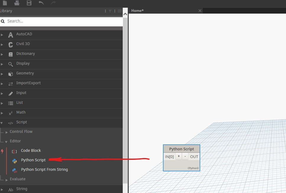

Thanks for your reply.
Where do I paste the code you gave me?
I would appreciate it if you could tell me.
