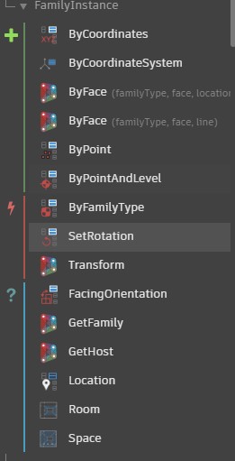

Hello, I am doing a graph and while checking online in forums, tutorials request to use the Familyinstance.gettype to complete the graph. However, when searching within the Dynamo library of nodes or by typing the search term, I cannot find this node.
I wanted to know if there is now a new equivalent node or another way to access the information developed by the FamilyInstance.GetType node. In the attached picture this node was supposed to be after the Gethost node but it is not there. Thank you in advance for any help.

Use the ElementType node instead.
ElementType
Thank you. This worked.
