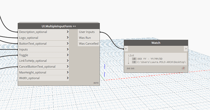

I found a node from data-shapes that generates a pop-up and allows a user to input something.
But now I’m having trouble using that data as an output…
In my case I need the file name and directory path to use for the export to excel.
Any suggestions or ideas?
In a code block:
data[0] will retrieve the typed name.
data[1] will retrieve the path.
I believe that data[1]+"\"+data[0] will combine the two into a file path. If that doesn’t work use data[1]+"\\"+data[0] (I can’t remember which is the escape character but muscle memory has me reaching for I think this character, but I am not at an American keyboard at the moment).
Thanks, that worked!
