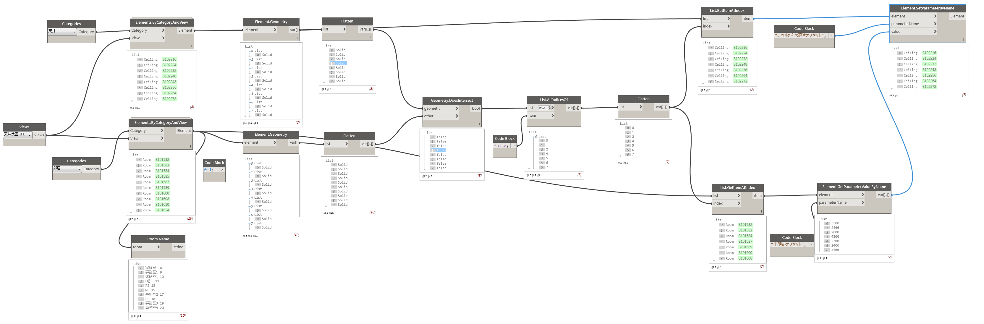

Hi.Please help me my .dyn.
Please check this attachment.
I want to make the relationship between Room and Ceiling.But I can’t.
Please give me some advice

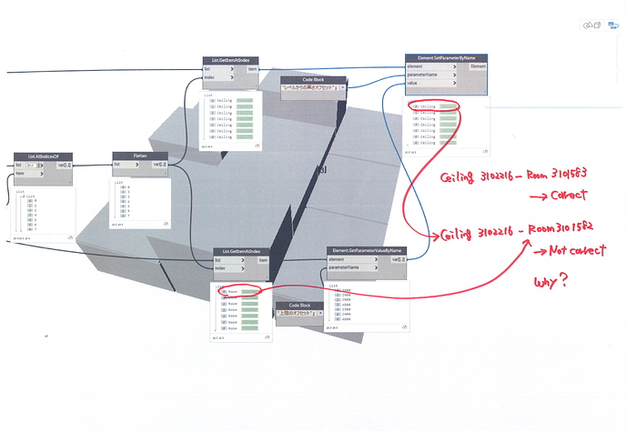

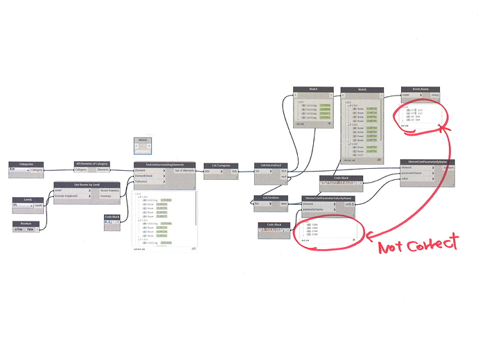

Hi,Kulkul.
I’m tryin your another way.But I can’t.
Why can I make the relationship between Room height and Ceiling height ?
Please give me some advice.

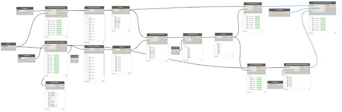

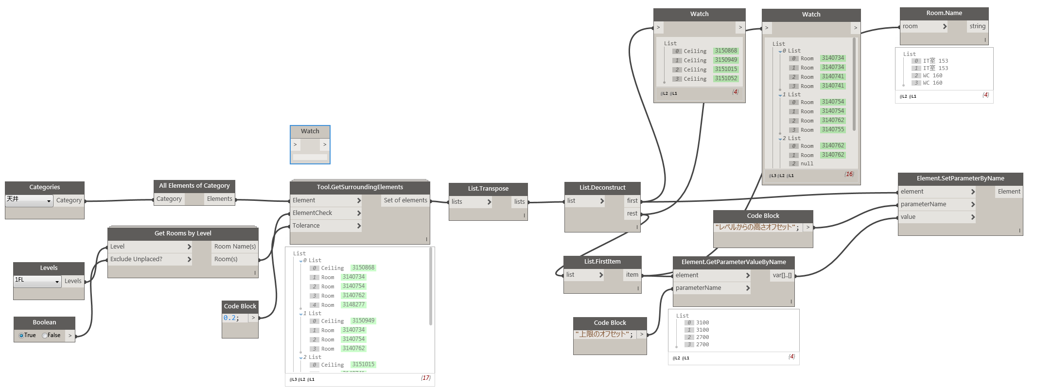

@s0443124 Check lacing on Geometry.DoesIntersect node it should be “CrossProduct”. Watch lacings.
I forgot to mention, it’s from Chynamo
Hi,kulkul.
Sorry I mistaked.
After change Crossproduct,I can.
Thank you your advice.
