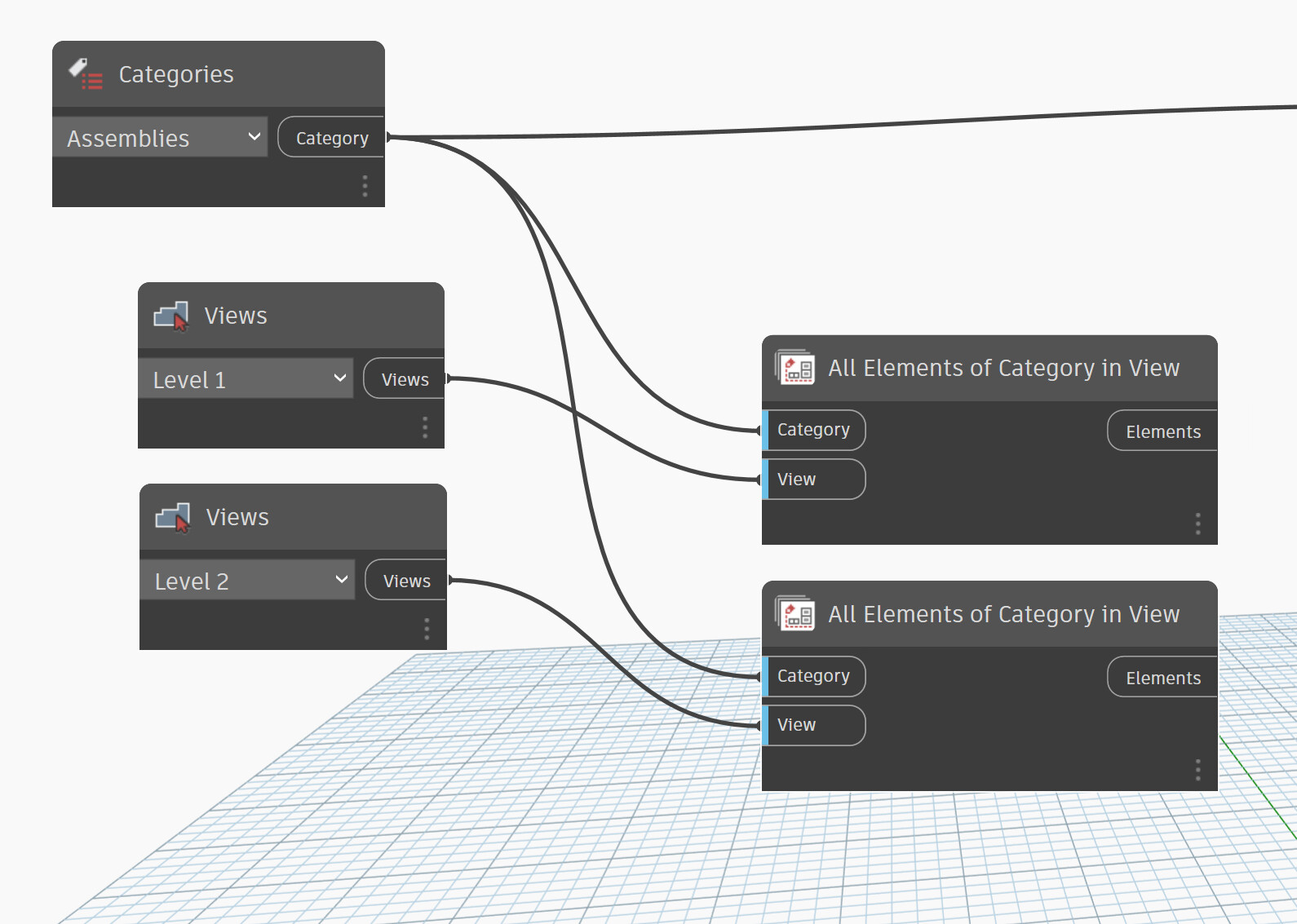

@Niels ,
you can start with this
KR
Andreas
it doesnt work it only gets the assemblys in a view. And I want the specific views of a assembly

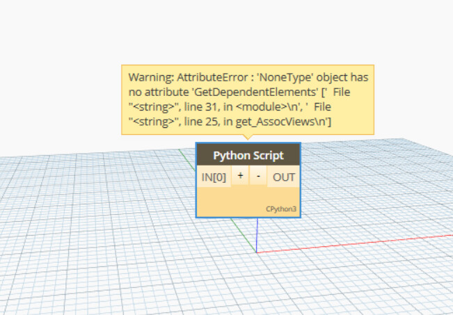

it doest work with mine
@Niels ,
try to run it in Ironpython2
KR
Andreas
I had multiple elements instead of one element
@Niels ,
you can implement a function is called IsInstance…
to solve the issue regarding list or single item
KR
Andreas
@Niels
because you have no input object
I updated the codes for a list of input objects
