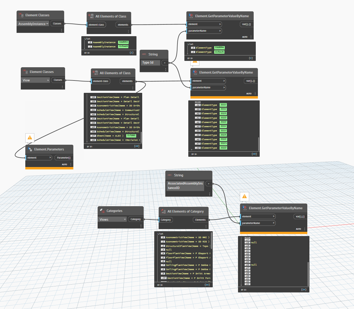

I would like to manipulate my assembly views, but I can’t find a reference to the assemblies in the Element.Parameter node. There is nothing that indicates that an assembly view actually is an assembly view. Type Id is the same for all the assembly views, but it’s different from the Type Id of the assembly. Surely they are associated with each other in some way?

did you try this ? you need to reverse this, get from the view the assembly ID ?

here is an example by assembly ID… you get the Ids of the created views…
