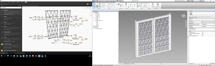

I’ve create a script to place adaptive components on points. I’ve selected the edges of a generic model to use as a framework for the point. When I change the height of the generic model the framework adjusts as expected, however it places new adaptive components families on the updated framework alongside the previously placed AC’s. Every time I run the script or set dynamo on automatic and change the height parameter, a set of new components are placed. Is there node or a workflow to simply adjust the AC’s instead of placing a new set of AC?
Your nodes are illegible. Are you using Python to place your adaptive families? You could have your graph delete existing instances before placing new ones.
No Python used, just OOTB nodes. Here is the graph. AC pattern.dyn (85.3 KB)

You’re going to have to explain your graph. What are the inputs? What drives the geometry change?
EDIT: I was able to figure out which curves to select and where, but the issue seems to be how the components are created. I think your best bet is to delete the existing instances and create new ones rather than trying to modify the existing ones. This will allow you to make changes at any time.
Basically, I’ve created a generic model which is a representation of a prefab concrete wall with bricks. I use the rectangular openings (select edges node) to drive the geometry changes. In other words, when I change the height or the width of the generic model, the placed adaptive components should flex as well. Since you can’t load adaptive components into a generic model family, I loaded the generic model and adaptive component member family into an empty adaptive component model family template. There I select the edges and run the script.
