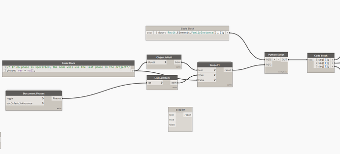

Is this a custom node you unpacked? It seems like the ScopeIf+ node acts as a simple if-gate here to switch between the phase which has been input by the user or, if there is no input by the user, the last phase from the Document.Phases list.
Personally I don’t like the OOTB IF nodes. They break far too easily.

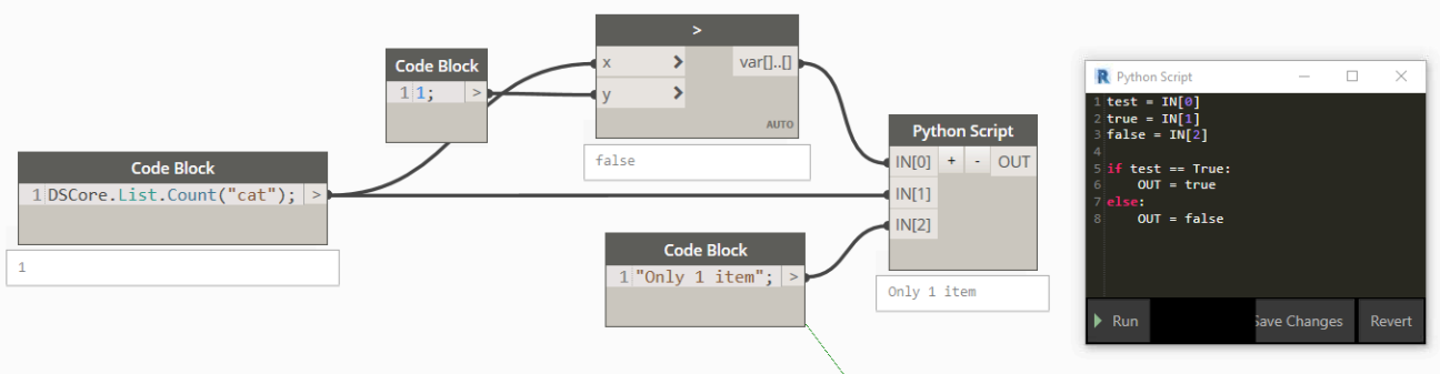

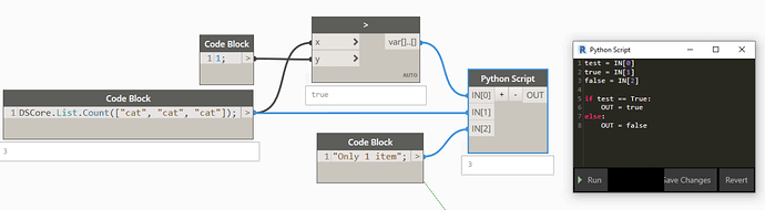

A very simple bit of Python will work:
@Draxl_Andreas, I’ve used that code block syntax as a workaround when working with lists of differing lengths. Several others have reported the regular IF node cropping the result at the length of the shortest list input. However, I believe this functionality has been merged into a more robust IF node in the latest version of Dynamo.

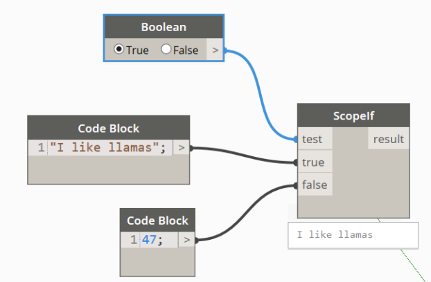

ScopeIf is typically meant for use inside custom nodes. It often fails when used in the graph environment (though it can work if used carefully). The purpose of ScopeIf is to only execute the nodes connected to the conditional input matching the test condition. i.e. If your test condition is true then the nodes feeding the true input will run as expected and return an output while the nodes feeding the false input will not execute at all.
You can see here that the nodes return nulls even though ScopeIf still returns the correct value.
