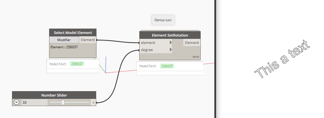

Following your request, I added support the for Model Text in the Element SetRotation node from the Genius Loci package.
You need to download this package and add the latest node that you can find on Github
(Right click and Save As on the Raw button.) Drop the new node in C:\Users\%USERNAME%\AppData\Roaming\Dynamo\Dynamo Revit<version>\packages\Genius Loci\dyf
