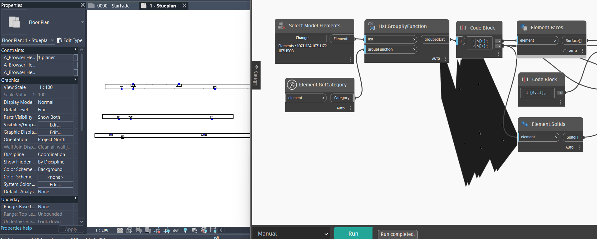

Hello try something here could probably work for you…
Revit_hcjJY6WKX5
forum elec.dyn (31.3 KB)

Hi @farshidkaviani something here should work on your sample file…ps nice with a dk template :wink:
Revit_cJUVIgnl2u
11forum elec.dyn (36.5 KB)
