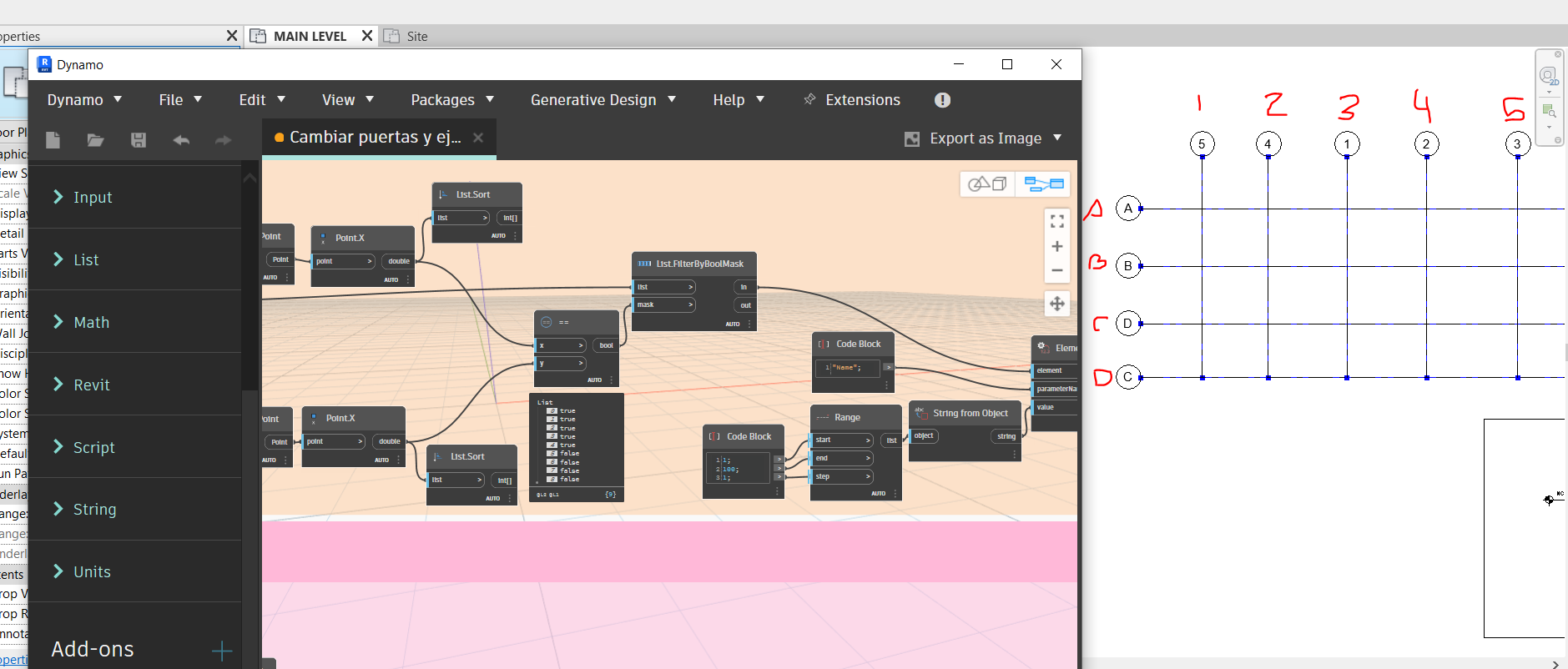

Hello everyone, I’m making a script to rename grids when you insert one between existing grids
the problem is dynamo organize by id, I get the X and Y location how can I use that information to rename left to right and up to down?
Thanks in advance!
Hi @ubriacocontrerasgust …hre is example for x direction…
and for alphabetic naming clockwork have some nodes for that or something,
I usually build these types of scripts by temporarily renaming them after sorting by the grids roughly orientated to X and Y axis’, then any rogue grids at angles get done manually.
If you don’t temporarily rename them, sometimes you’ll end up with errors such as an H grid with a number that a V grid tries to use before it has been renamed, so it causes a duplicate name error and prevents the process working.
Grid numbering.dyn (57.4 KB)
Great! thanks a lot was very helpful!
