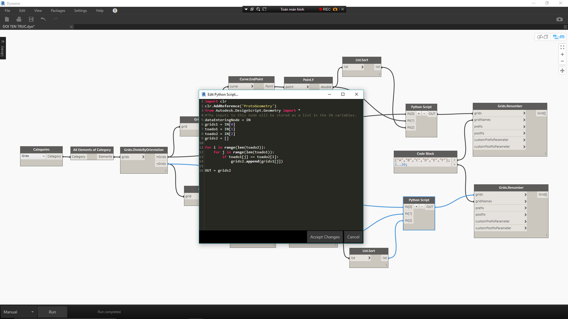

I FOUND THIS SOLUTION WITH YOUR HELP
SEE IMAGE :slight_smile:
i used Select Grids By Curve node.(thanks to Rhythm)
i have different direction for renaming so i used two lines.
ITS WORK FOR ME GREAT.
and for start grid J to X i will write code block. “j”,“k”,…etc. its fine.
i am a new learner so these steps are good for me.
and sorry to @xaydungxt.36 i cant use your method, because i am a new learner and i am not ready for PYTHON SCRIPT . i appreciate your help.
