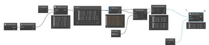

If I am following you correctly and you want to move all objects from layer “123” to layer “456”, you just need to pass the “all objects on layer” output to the set node. If you are looking to just move circles from layer “123”, you could do something like this.
Perfect. Thanks Devin, this did exactly what i was looking for. Ill spend some time and process this. Thankyou!
