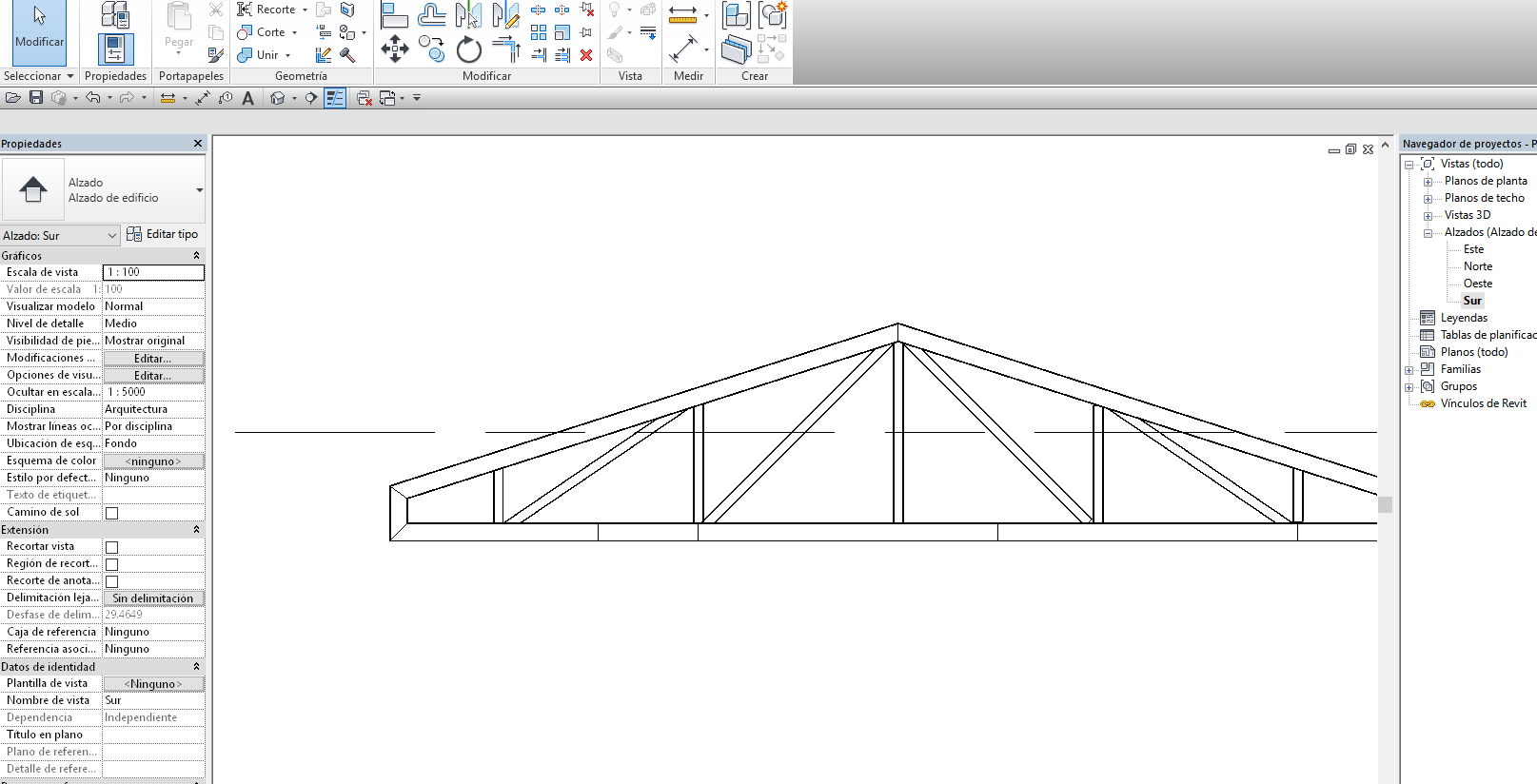

Hi, I’m new using Dynamo for a structure so, I don’t know if there is a method to change the union between two or more beams using Dynamo and not going one per one in revit after the importation using StructuralFraming.BeamByCurve.

I’ve explored a bit, but I’m not sure of any step. In dynamo I’ve got like in the picture. And what I’m trying is the good result in revit. Can you help me?
I don’t know of access to the native miter or coping options, but you can achieve this by incorporating unique end controls of your framing families. These would include positive/negative start/end offsets as well as positive/negative start/end miters. Its a bit of up front work but for non-concrete elements it creates very specific and consistent control of member joins.
