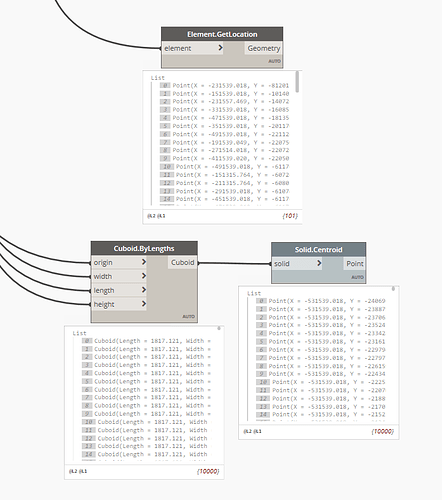

There are elements placed on a surface formed by cuboids.
Is there any way to know what specific cuboid each element is in?
(the coordinates of the centroids are different from the coordinates of the elements)
Thanks to all

Thanks @Vikram_Subbaiah !
Yes the problem is that, but I tried and in my case it doesn’t work, I don’t know why, the points should be inside the cuboids, but the intersections are all false.
Right click on AUTO of Geometry.DoesIntersect and change Lacing to Cross Product
Thank you so much!
