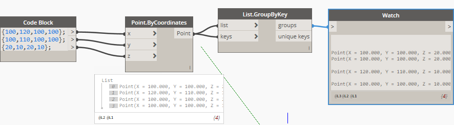

Hi.
I’m trying to group by multiple keys.
I want to group the columns in the same location. (x == x, y == y, z == z)
this result is what i want:
List
Point(100, 100, 20)
Point(120, 110, 10)
Point(100, 100, 20)
Point(100, 100, 10)
List
0 List
Point(100, 100, 20)
Point(100, 100, 20)
1 List
Point(120, 110, 10)
2 List
Point(100, 100, 10)
I’m having difficulty trying to group groups.
thank you.

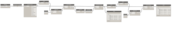

Hi @minji
You could do something like this:
@Jonathan.Olesen
that was easy. thank you so much!!
