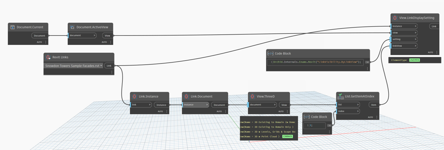

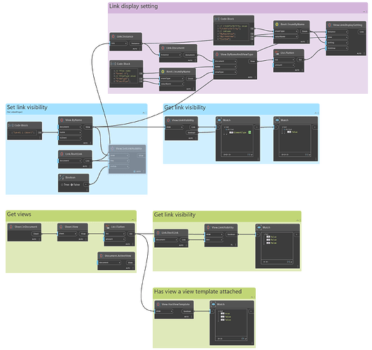

I had managed to work out a basic logic as shown below. Workflow still needs refining but at least it works.
Sample provided by Erik below as well.
Reference issue on github: Any Sample of View.LinkDisplaySetting usage? · Issue #270 · erfajo/OrchidForDynamo · GitHub
I believe this can be considered a solution?
