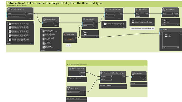

I’ve been playing around with getting SpecTypes and I was wondering where one could find a more comprehensive list regarding those SpecType Id inputs (referring to quoted post), which I’m now only able to get through a Dropdown node.
I would like to have multiple SpecTypes input, perhaps preferably in a Data-Shapes or other interface, so the dropdown node isn’t ideal for that. And it only allows the user to have a single input, instead of a code block list with multiple.
What I’ve got now works, but isn’t great since it just works with ForgeTypeIds, which I don’t really understand haha
What I’ve got now (above group) seems to work, kinda, it retrieves all ForgeTypeIds, not really sure what those are, and I’ve filtered them to the desired ones and then wrote some python to get the unit types of those spec types. I’ve tried getting that python code from within the first Clockwork node, but I just can’t get it to work, even when copying the code 1:1 into my workspace.

This is a bit quick and dirty as will have a few methods hiding the list (Equals, GetType, GetHashCode)
[p for p in dir(SpecTypeId) if "_" not in p]
If it is an attribute you can get the object it with eval(f"SpecTypeId.{p}")
I found a workflow how to retrieve the Spec Type names: Create a project and create a family in there. In that family, start to add paraeters of different types… Yes/No, Material, Length,… then run the script attached and see what the string is you need to pass on.
