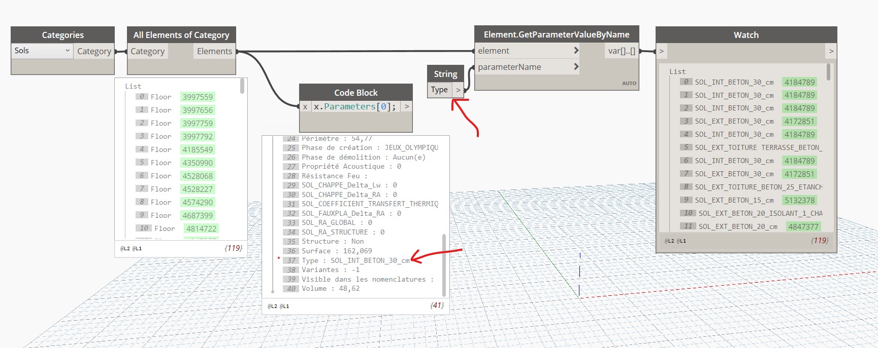

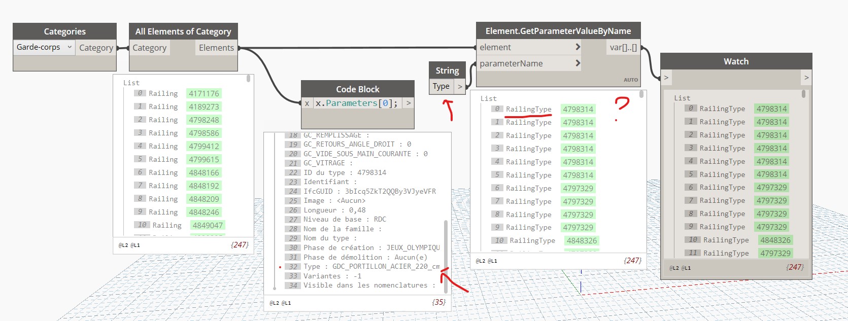

Is there a way to get the data of the family type ? I’ve tried two different ways, but failed.
It works with the wall, but not window, handrail.
@Alban_de_Chasteigner @thongle3103
Dynamo_GetDataType04a
Hi Congzheng,
It’s easy to retrieve the types of the system families with Element.ElementType, Family or Family and Type parameters.
However, it is not possible to find the Family(element) for system families. But it is possible to retrieve the name of the base family with the Element GetLoadableFamily node.
That’s very magic. Thanks a lot.
“Type” for floor category is working
“Type” for window category is somehow working
“Type” for handrail category was not working, but with “e.Name” block, it works very well.
How to understand the principle of revit logic? when we use “e.Name” block, how can it knows we are looking for the “Type” name, instead of other names?
Hi @Congzheng
We use code block to take that object’s name. In this case, we are asking the code block to show the name of the parameter called “Type”.
You can look for more information in the Design Script document. It would be very useful to use design script in code block.
Nice ! Thank you very much.
