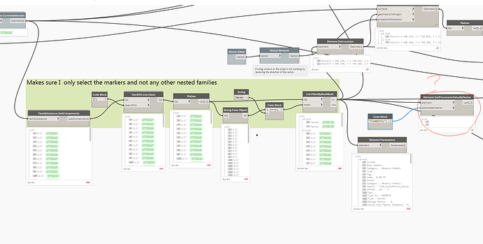

I dont seem to be able to pull the parameter values in from a nested family. Any Ideas what I am doing wrong?

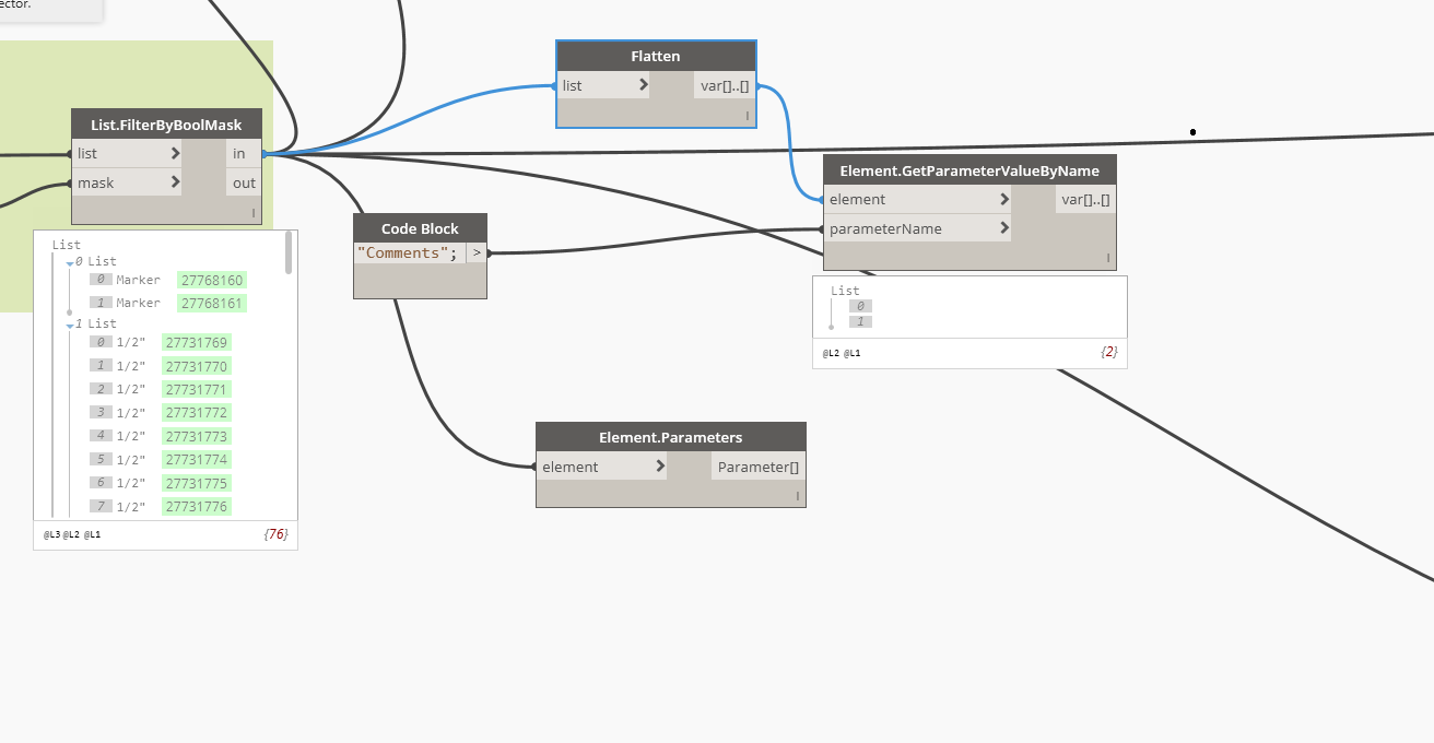

Maybe try flattening the elements list before sending it into the Element.GetParameterValueByName node…
Thanks for your reply PauLtus, Im not sure what good that would do, since its already a flattened list, but I tried it anyways with the same results.
Can you extend your first screenshot so that we can see the whole window, also name etc. It seems that “Comments” is not a parameter attribute of the markers…

Sure,

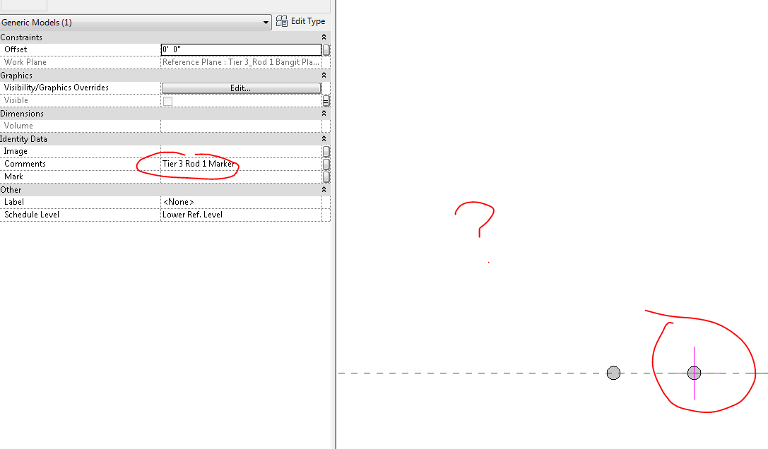

For every marker, I wrote the appropriate comment into its parameter value, and I need to be able to distinguish each marker from each other but its not seeing those values for some reason
